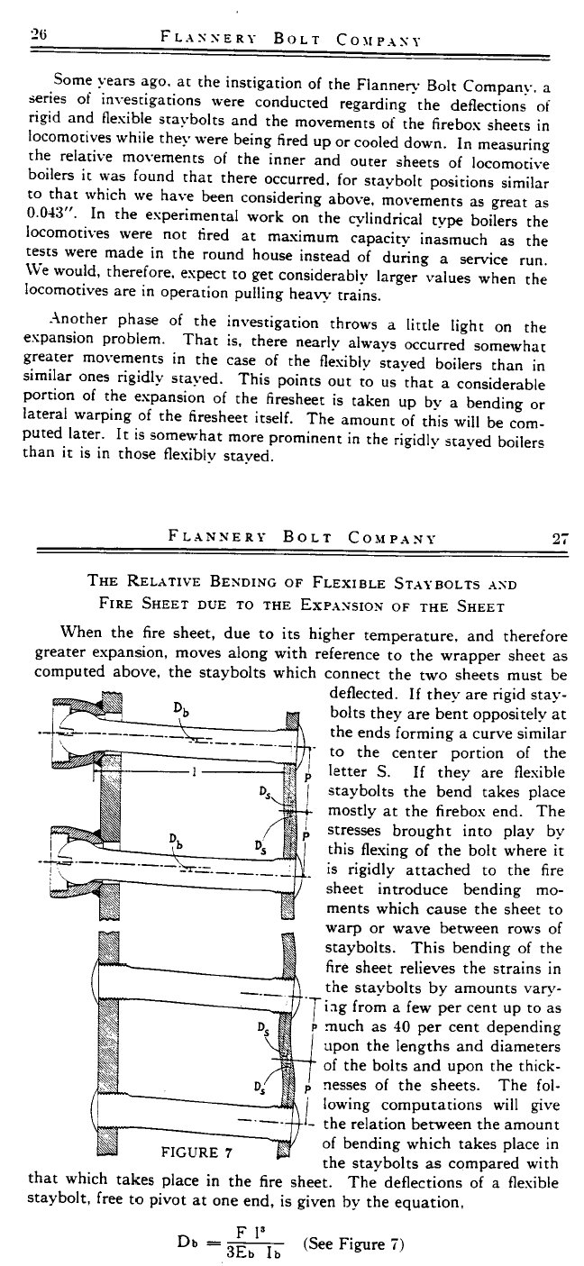

Add together calculated deflection plus high firing rates plus scale to increase sheet temps to 850F+ and wavy side sheets should be expected. Not a safety issue until the staybolts cannot be properly caulked.

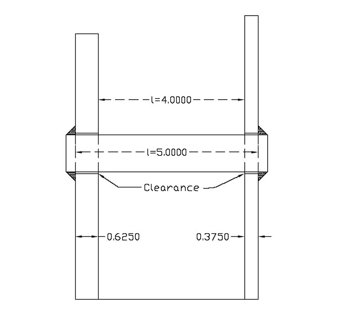

Second, flexing in threaded vs. welded staybolt installation. Should be no noticeable difference if a threaded bolt is hammered to fill the threaded hole as per industry standards. This is comparing full penetration welds.
If it is a fillet welded bolt, then the free length of the staybolt, the "l" value, will increase by about an inch for rigid staybolts. This length value is cubed in most of the deflection equations. Not sure how many of the fillet welded staybolt advocates have recognized the significance of this.
4^3=64 5^3=125
Had a request for the full Flannery booklet. It can be downloaded via the link in this post:
viewtopic.php?f=1&t=28659&p=136777#p136777

Seems the flow of things has been altered somewhat, rendering Matt's pictorial contribution fatherless now. Pity - it did answer one very good question and one that needn't have been asked, but one good question out of 2 is a very good average given the amount of foamy drivel in other threads lately.
Yes, fillet welded stays are "longer" than FP welded stays or threaded stays. It makes some considerable difference.

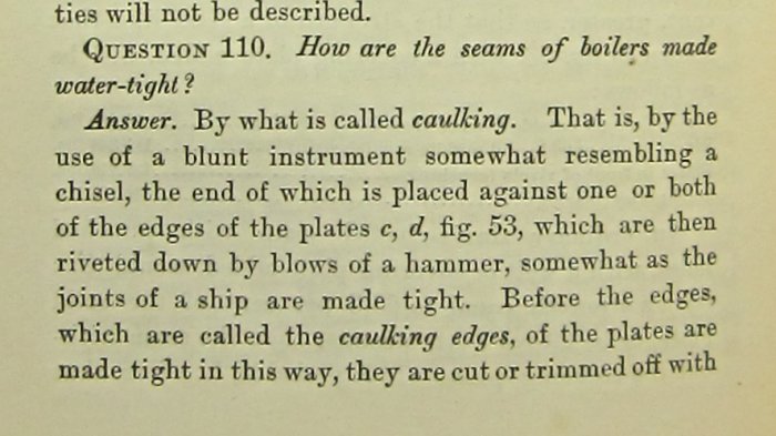

I appreciate the discussion and the book references. How about posting; plates c,d, fig. 53...
Wikipedia; Iron or steel ship caulking;
In riveted steel or iron ship construction, caulking was a process of rendering seams watertight by driving a thick, blunt chisel-like tool into the plating adjacent to the seam. This had the effect of displacing the metal into a close fit with the adjoining piece.

My reading was that calculations for fillet welded bolts needed to take into consideration the total distance between the welds, rather than just the width of the water space alone - not an indictment of the filet welding concept in its entirety. I'd like very much to know more about how to correctly do calculations on Tross bolts installed with fillet welds in order to understand how they compare with ordinary screwed bolts or FP welded bolts in identical boilers. There are more right ways than one to get any job done, but sometimes one way may suit one particular set of circumstances better than others.
dave
