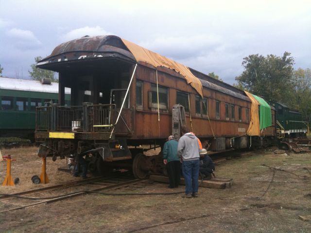

I wonder if that is this car. I saw them doing a truck swap on it last September.

It sounds like they jumped into the project without an accurate cost, and bailed when the real costs surfaced. It is the car in the picture.
