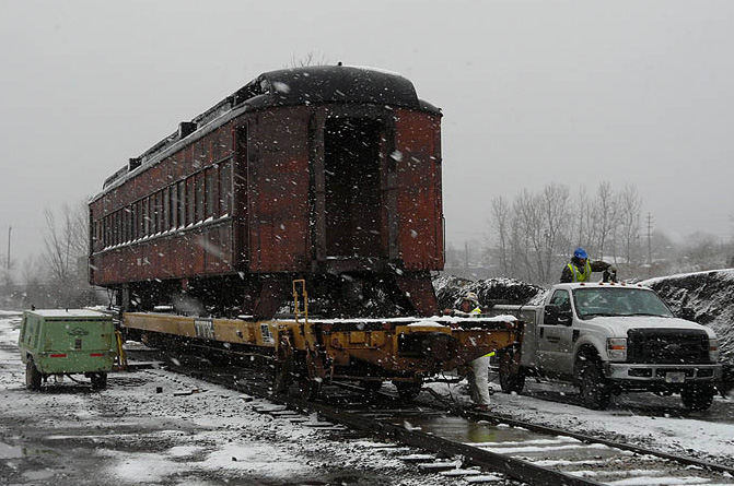

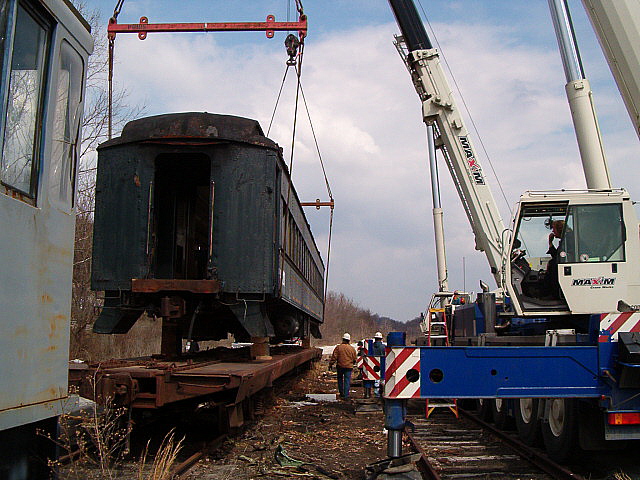

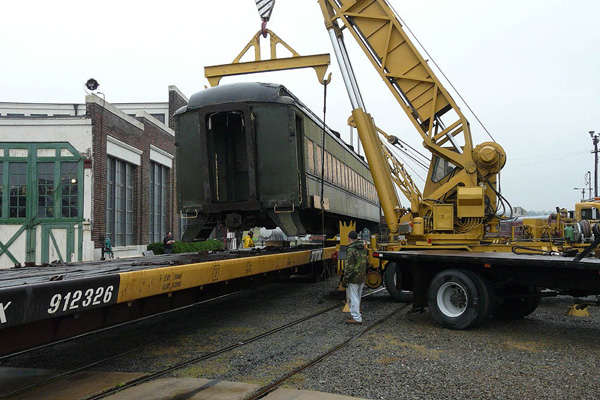

railadventures wrote:
Does anyone on the List have experience with moving a vintage passenger or freight car (not suitable for interchange) via a flat or depressed center rail car?
Unfortunately, yes. More than once.
You may want to use the search feature here as the topic has been discussed before.
You will need to become familiar with the AAR Open Top Loading Rules, get to know the clearance bureau at your local railroad, and I recommend locating an experienced rigger. I found working with companies that pick up derailments gets you someone with knowledge of railroad equipment, procedures, and personnel.
Alan Maples
Everett Railroad
File comment: Even more fun in a snow storm.
