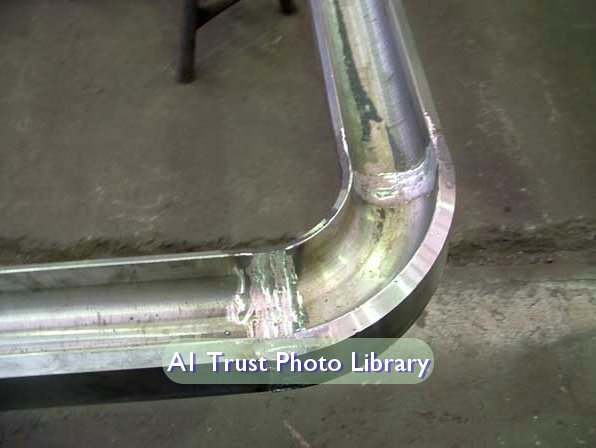

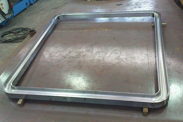

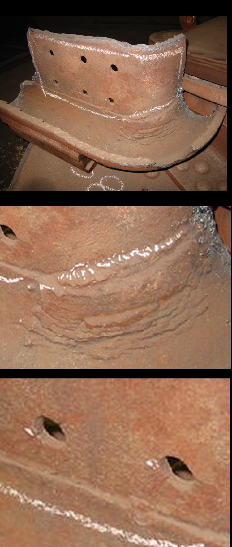

It seems the Germans were no strangers to cracking in the corners of the mud troughs.
How many defects can be found in this particular instance?
This photo was found in the
German Wikipedia listing for "Steam Locomotive Boiler" translated here for your convenience.
Tornado and 3801 mud troughs are shown for comparison.

I, too, was curious as to why such significant work was needed so soon after being turned out shop fresh. Now I understand - they should have used a solid mud ring instead of an oversized traction engine mud bottom... (stated with a hint of sarcasm - they also use dainty copper fireboxes across the pond)
Actually, I don't think that's the problem here - seems to be an issue with significant breaking of the stays. If I dig enough, I could probably find the answer, but it looks as though they are threaded and driven and not welded. Anyone know if this is the case off the top of your head? I did not see any report of where the broken bolts were occurring (pattern or general area(s) of breakage). More flexible bolts could be the answer.
Just because drawings and specs from the original Peppercorns did show or use a certain amount of flexibles vs. rigids does not mean the designs were beyond reproach. Also, it seems that problem areas could have been repaired/modified in the roundhouse rather than the backshop. Remember, roundhouse foremen had to keep the things running, and would have done whatever made their lives easier. So many variations from the drawings are incredibly common with railroad things as we all know.
Remember the originally A-1 boilers were riveted construction while the Tornado's is all-welded. There may or may not be a lot of changes in other details compared to the original boiler design.
I can imagine that there would be significant differences in the loads and stresses on staybolts between fireboxes with solid foundation rings and the U-type welded foundation ring seen in the photos. Maybe that's part of the problem?

I'm amazed at the "trough" instead of a mud ring. That thing begs for trouble to happen.
