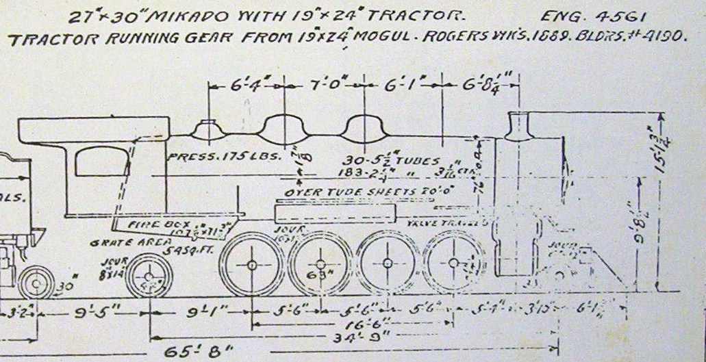

Posts: 490
This is a close as I can get. It is a plan for a "Tractor", but gives the basics for a 4500 series loco. Good luck!
