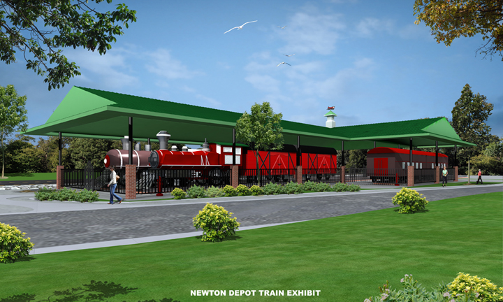

Our new estimates arrived, and frankly, have blown us out of the water. Our carbarn (L-shaped), with the skinny part being 40 x 120 and another 25 x 60 feet making the fat part came in 50% higher than expected. This included the building with its gabled roof; $36,000 in concrete sidewalks; $30k in five foot steel "spiked" fencing; $12k in lighting; etc.
Here is the architect rendering of what we originally wanted:
Now, honestly, I am not for building the Taj Mahal here. I think/hope people will come to see the equipment, NOT the building, and would like to approach it from the other end. A similar building to this style:

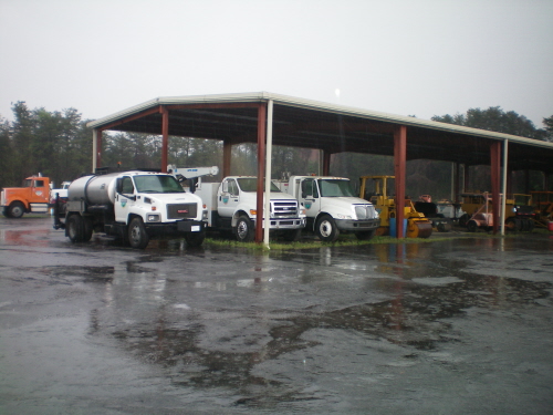

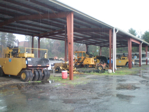

This style of building can be built for closer to $100,000, sacrificing lighting, fencing, and concrete sidewalks. However, even not sacrificing these things, the cost is STILL considerably less than what was originally designed. Unfortunately, there is some resistance on the board in going with this scaled back version because it is not "classy" enough (too strong a word, but you know what I mean).
Sooo, bottom line, how would YOU dress up the very basic shed shown in the bottom two photos and make it more appealing and secure, without breaking the bank?
For starters, I would paint all steel beams black, except those at the ceiling (white), put up a 4' black chain link fence, brick up the steel beams about 5' high, and put in bird netting and SOME lighting. For walkways, I would use pea gravel and flagstone with a "brick paver" campaign that would always be ongoing...
What would you do (to the building, please no advice on inter-board tastes and politics)?

Matt,
Our new buildings were constructed using steel systems buildings (like Butler and Corle) and then enhanced with brick facades and trimwork to get the architectural atmosphere we were seeking. Viewed from the back, they are quite plain. We also were able to do some of the interior electrical work at more favorable pricing after the general contractor was off the scene.
My sense is that you can probably find a middle ground between the original design and the "car port" shown below it.
I think you have outlined a good compromise here. And if things get tight you could install electric service and add lighting later. Or install simple fixtures (equivalent of bare bulbs) and upgrade the fixtures at a later date.

Matt Bumgarner wrote:
...how would YOU dress up the very basic shed shown in the bottom two photos and make it more appealing and secure...?
Matt Bumgarner
Once painted with a nice enamel, I think a prefab structure like that will look just fine.
You could also shop around to see what other off-the-shelf designs are available in your budget. Below is a simple shelter I noticed today:

With some steel studs, chicken wire, and stucco you can box the columns in and make them look much better for very little money. Maybe even three feet of brick at the bottom. Paint the under side of the roof flat black. It will disappear so it does not matter what it looks like. Black chain link fencing will look very good. Do not under estimate the problem of birds in an open building. I have no good answer for that problem.
You should consider staying with the concrete walkways between the cars. Anything else and there will be tripping hazards and ADA issues. You do not need a full floor, just pave where you want your visitors to walk.
