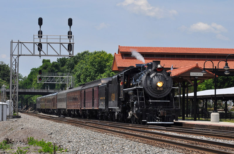

Not only were diesels missing from the steam trips this past weekend (hallelujah!) but something else was also missing. I was really surprised to see an almost complete lack of smoke from the 630's stack. I have never witnessed a hand fired coal-burning locomotive with practically no smoke.
How is this coal treated so that smoke production is so minimized? What is happening in the firebox over conventional coal consumption? Where is it purchased? How much more does it cost compared to conventional coal? How long has it been available?
I'm sure some on this board can enlighten me. I've included a photo taken on Saturday and of course, no smoke.

Your right! That is a clean stack. I used to run steam locomotives at a nearby amusement park which were oil fired and I could never get my stack that clean. I bet G. Mark Ray has the answer.

Proper firing and good less-smoke coal.
This is good for the neighbors around the museum. Personally, I thought the smoky stuff fired a little better, but I like this stuff too. We've used this several times over the last couple years so many recent pictures, at least with 610 are similar. I found that you really have to over fire to get this stuff smoking above a slight haze, whereas the stuff we had been using for the past year generally carried a mild haze with a good even fire.

If this is anything like other "smokeless" coals i have dealt with over the years, it is fairly pricey. Perhaps $220ton lest it is bought by the hopper loads. The best coal I have ever fired is a west virginia product, low sulfur, ultra low ash, HOT burning, quick to catch, no smoke and only about $160 a ton delivered. Only downside, and ultimately the reason it was used for only a weekend, the cinders coming out the stack (only 2mm or so in size) were still glowing as they came down even 2-3 cars back. They were in quantity enough and with sufficient thermal value to burn hats, heads and set about a dozen fires over two days.
With the exception of the fire issues, I hated to see the stuff go.
A question to the TVRM folks, in the vid i posted is a scene with the locomotive passing under a bridge. The coal looks like unwashed "mine run" rather than the 3x5 (plus not minus) one would like to see on a hand fired engine, how did such a small coal end up in the tender? Availability or vendor issues?

Here is the truth vs the myth of railroads which ran coal burning locomotives: You burn what you've got. Many railroads owned coal mines and some of their mines had very good coal. The purpose of the stockholders owning railroads and mines was to make money. There was no money in burning the best coal in your own locomotives; there was money in selling it to other people. The L&N had some exceptional mines in Kentucky but they often brought in coal from Alabama (Alabama swell belly) to burn in their locomotives in Kentucky. Why? They couldn't give away the crap they had in Alabama but they could get real money for their good stuff. The company specs for what they considered perfect for a stoker or hand-fired locomotive really meant nothing. What mattered was what showed up in the tender. You just dealt with it and made it work the best you could. Pull out as many of the big rocks and slate you can or wet down the powder and make it work. I actually have quite a bit of experience hand-firing coal burners and always made it work.
David, Ryan and crew seem to be doing an exceptional job of keeping 630 hot in spite of the, apparently, wrong size of the coal.

In the time I have been with TVRM, we've generally always used finer coal. We've had several loads of larger coal and a general consensus amongst several of us was the fact we didn't like it. There was no real difference in work load as far as shoveling more tons per day. As far as the recent change, I think it had a lot to do with the fact that it made almost no ash, which is good in one way, but after a few full day of service on the local trips, we still never shook ash and barely had enough under the green coal to keep the grates covered and very little was dumped every morning. The smokiness was also a major factor. I think it had a lot more volatile gases in it versus the current, I swear it was smoking and ignited almost as soon as the scoop landed. The new stuff we have gives a generous amount of ash and a lot less smoke, and takes a little longer before it ignites, but it stays alive a lot longer as well.
Also, its been the same person ordering the coal for probably the last 20 years, I think he knows well who to call to get what he wants. We knew that he wanted to switch long before he did.
