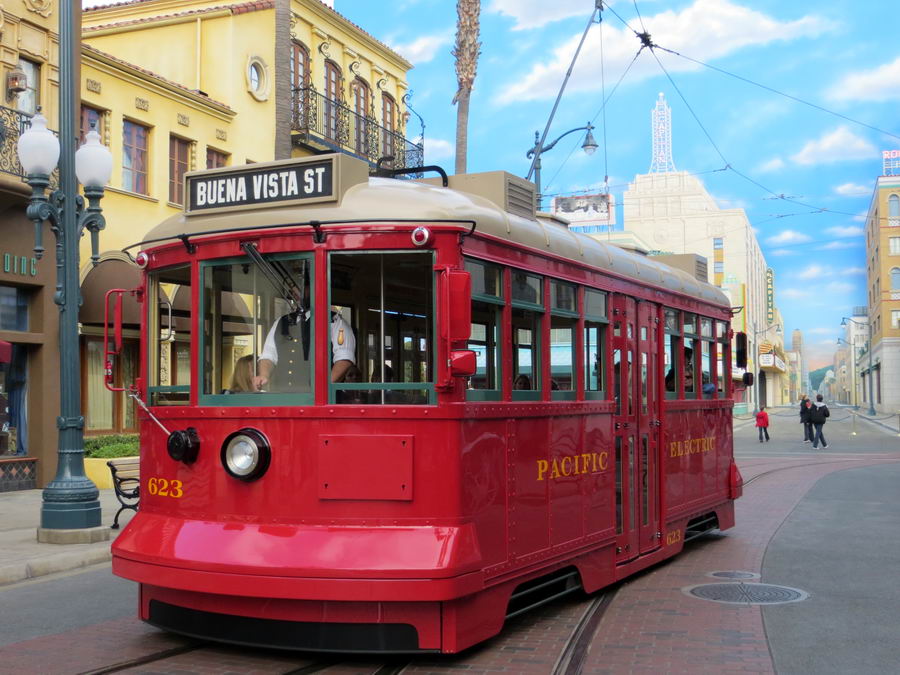

Speaking of a Disney project, how about this photo from John Smatlak of the great Orange Empire Railway Museum.
This is a new Disney theme park in California. The Brookville Equipment-built mini-Hollywood car actually runs on batteries and the overhead is not energized. The scene in the background is painted! Ahh, to have money, eh?
