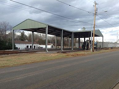

The SE Narrow Gauge & Shortline Museum/Alexander Chapter NRHS is currently finishing a metal structure that cost us $280k, and was cheaper than a conventional pole barn for the dimensions we have.
The barn is L shaped and has 2 dual guage storage tracks that are 120 feet long each, and the smaller third track is 60 feet long. We have concrete sidewalks around the perimeter of the building and between each track. Height is very important and was a major component of our cost. We built it so that the bottom of the eve was 20 feet from the top of the rail. This height caused our concrete footers to be 7" x 7" for wind resistance!
Sorry I don't have a better photo handy...
Matt Bumgarner

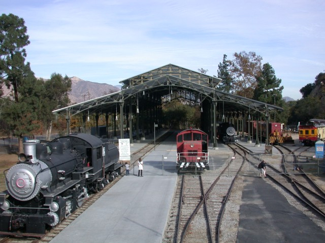

Steve,
I like this design for maximum track under roof and also viewing aesthetics. Modular design add to length as funds become available, sides can be added and/ or sections of it could be walled in to use as a shop. If you wanted to you could add a 7th track down the center for under roof storage when the museum is not open. Unknown photographer Travel Town, Los Angeles, CA
Mike Tillger
