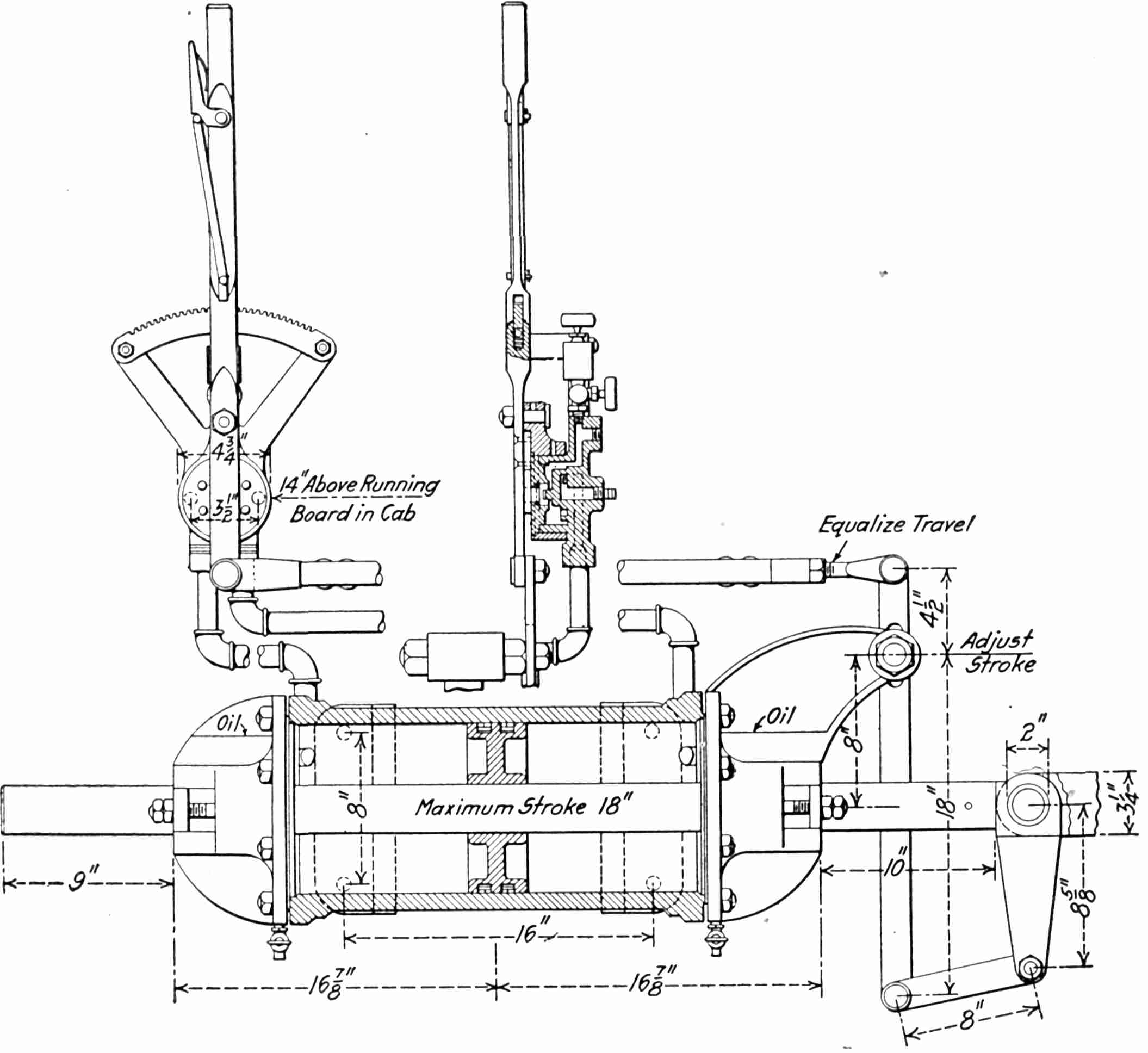

Please be a little more specific as Baldwin purchased usage rights to several inventor's reversers and manufactured them under their own name. The brand of reverser was typically chosen by the purchaser of the locomotive and listed on the specification sheet.
Pic is from 1922 Loco cyclopedia showing a Lewis type reverser similar to the one used on BLW shop switcher #26. This was added when the locomotive was sold to Jackson Iron & Steel, as it was built with a Johnson bar.

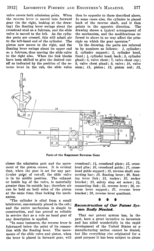

Does this help?
