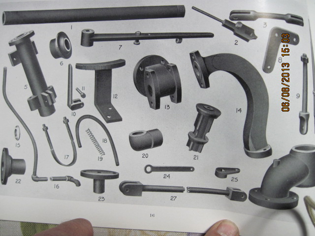

I'm going to need to make a new throttle valve for a larger Vulcan Iron Works locomotive; perhaps we can help each other out. Unlike British practice, US throttles liift a spool out of a double seated hole in a casting by means of a bell crank.
dave

Vulcan valve like this? Dave
 Post subject: Re: Davenport Help
PostPosted: Sat Jun 08, 2013 3:18 pm
Thanks Digger Dave. I'll PM you a link to drawings if you like.
Are you in the foundry business by any chance?
dave
