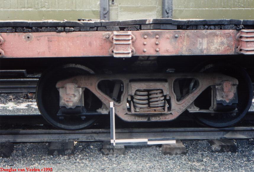

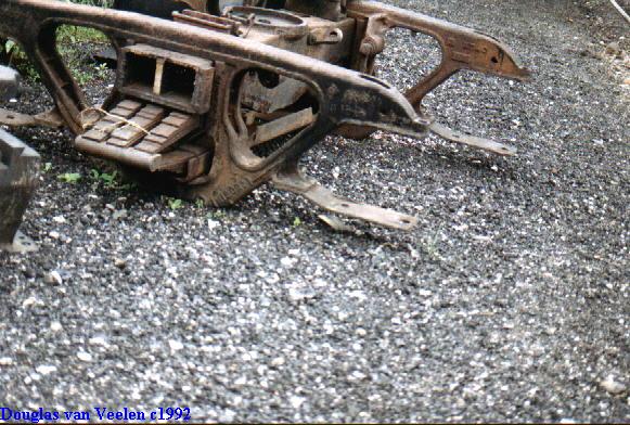

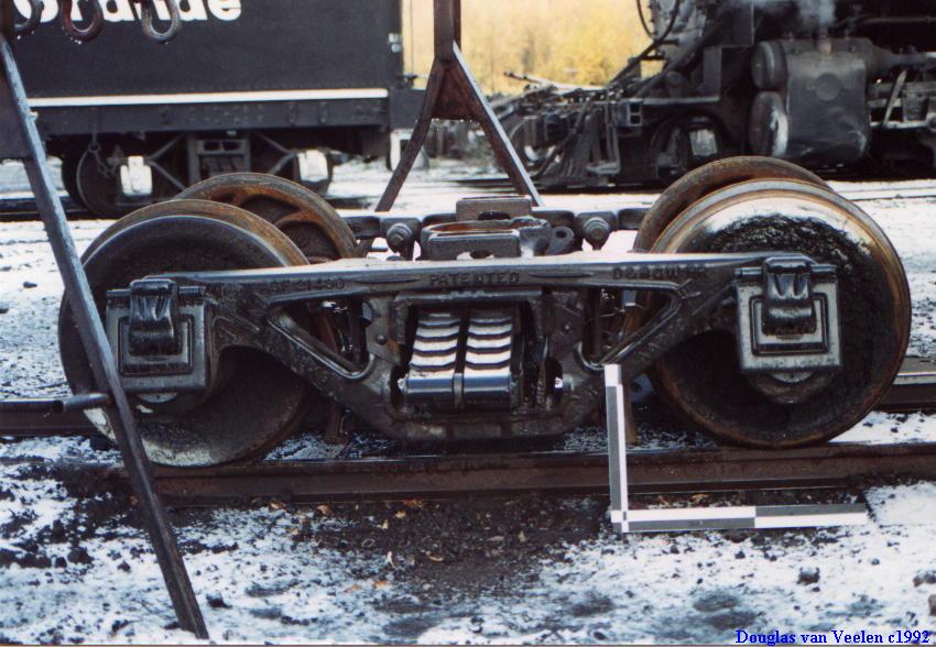

The D&RGW (now C&TS) has two kinds of Andrews trucks - the 3-piece and the 1-piece. I assume you are talking about the one piece. The 3-piece has the journals bolted on the side frame.
one piece Andrews:
three piece Andrews:
If you want more photos, PM me and I'll email them to you.
I posted all my photos on the NGDF around Christmas 2016.
Doug vV

What you refer to as a one piece Andrews truck is a Bettendorf truck. The Andrews was designed so a railroad could use the journal boxes from their archbar trucks to reduce the cost of converting to cast side frames.
 Post subject: Re: Andrews trucks
PostPosted: Fri May 12, 2017 10:16 am
Joined: Thu Nov 04, 2004 6:15 pm
Posts: 41
Location: Lansing, Michigan
Close. Whereas Andrews was the nearly-universal name of the three-piece, cast truck design with bolted-on journals as shown in the second D&RGW photograph, the Bettendorf Company was only one of several prolific makers of one-piece, cast-sideframe, U-section frame member trucks. Because their name so often shows up prominently in the castings, railfans and model railroad manufacturers at some point adopted the name Bettendorf to apply to any truck of the same basic type. However, The Bettendorf Company also made trucks with T-section frame members, and lots of other companies also made nearly-identical, one-piece, cast-sideframe, U-section frame member trucks.
Most of the latter complied more or less with an ARA/AAR patented standard for one-piece, U-section cast truck frame design, and so at the urging of several noted scholars of freight car design, railfandom (and the museum world) has gradually been adopting minor variants of the name "ARA cast sideframe" or later the "AAR cast sideframe" (after a 1934 merger of the ARA with other railroad trade organizations), to describe any truck which complies with the same overall configuration, even where minor detail and contour variants occur.
I don't know if this is what the railroads called them, too, but it does tend to be a bit more accurate.
And--to more directly address the original topic--while I don't know enough about the practice to know if there is any reason for this not to be a good idea, or whether it offers any advantages, I have seen Andrews sideframes either jacked or lifted by other means, the journals unbolted, and the wheel and axle sets rolled out of the ends of the frames, still on the rails, with the journals still fitted to the axle ends.

Posts: 914
Hi,
At one time, I was under the miss-understanding that all one piece trucks side frame were bettedorf (I can recognize Fox trucks for instance). If you look at the name of the file for the first photo it is bett-01.jpg showing my misunderstanding. People on the NGDF corrected my misunderstanding - I just did not rename the photo file names.
Both the C&TS railroad and members of the Friends were quite helpful.
Doug vV
