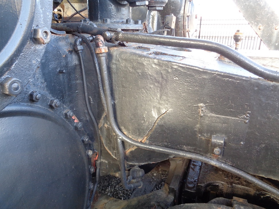

Photo by me - the file says 12/2015

Really not as bad as people make it out to be. Could be easily repaired if someone wanted to throw some money into it.

A lot depends on the crack, it's location, etc....
If the repair was done right, it should be stronger than the original material...
Typically, you don't just weld down the length of the crack....as it will just crack thru again...you have to do things like stop drill it to relieve at least some of the stresses, prep it to allow proper/ maximum weld penetration, etc.... It may also require adding doubler plates,etc...
frame cracks and repairs of such are pretty common in steam locomotives.... But on a big locomotive they can be considered too expensive, difficult, etc ...

You would be amazed at how the railways could piece a locomotive back together when they want to. Crawl around just about any locomotive's frame and you find some VERY impressive (and massive) weld repairs.

Thanks to everyone for the feedback. That does appear to settle the question: yes, there is a crack, but NS's inspection of the crack didn't preclude 2156's movement to/from Roanoke.
Follow-on question, but disclaimer first: no, it's not going to get restored to operation (no reason, no money, no place to run, etc). No dispute there.
But if it were to operate again-does operating the locomotive place more stress on this frame crack, vs. the stresses incurred in hauling it dead-in-tow?

The "crack" occurred at MOT, it's caused by freeze damage. The cavity behind it is full of lead. Water got in between the lead and the frame, over time it caused the crack to grow. When I first saw the locomotive in the 80's the crack was about 2 inches long. Had it not been for the added lead, it never would have occurred. Water is a powerfull thing.
If the engine were to be made operational the damage would have to be repaired. The lead would have to be melted out and standard procedures for repairs to a cast steel frame would have to be followed. Not a big deal, just takes a little time and hopefully a cool day. The damage is not an issue for towing the locomotive around in essetially light engine moves. Different story if tonnage trains were coupled to the pilot.
While we are on cracks on 2156, there was tales told of a cracked side rod. There was not a cracked side rod, there was a side rod that was torch cut in two at MOT. I forget the year but the engine was getting moved and someone did not put the wrist pin in all of the way and while moving the locomotive the side rod was bent when it struck the back of the wrist pin. Everything was wedged in so the rod was cut to expedite it's removal. It was then welded back together later. That damage was temporarily repaired prior to movement to Roanoke. If the locomotive were to be made operational that rod would need to be replaced.
