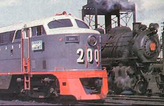

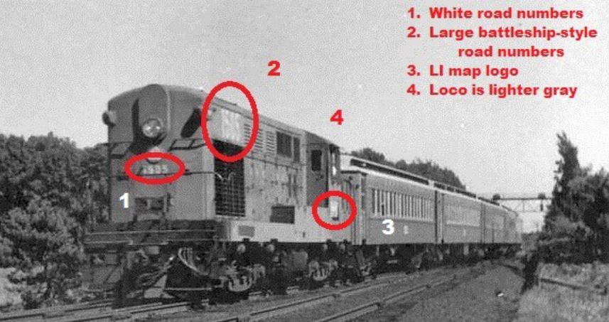

Post WWII the LIRR started to transition to diesels. Among the earliest mainline diesels were the FM C Liners and H series road switchers as well as the second group of Alco RS-1s, delivered in the Tichy scheme. These locos carried prominent "naval style" numbers on the nose. The C Liner with the black shading, looks most like what you would see on the bow of a warship. I assume this paint scheme's use of the numbers was influenced by the times. Hence the term battleship numbers.
In an unrelated note, in the late 1970s, one president of the LIRR was the leading US WWII fighter ace in the ETO, Francis Gabreski. I believe he named multiple pieces of LIRR equipment after WWII fighter planes (example: the wedge plow JAWSIII). His story and history are worth a read.
Alco RS1 467 is the last LIRR locomotive left around to have worn the paint scheme, and it is to this livery I will restore her.

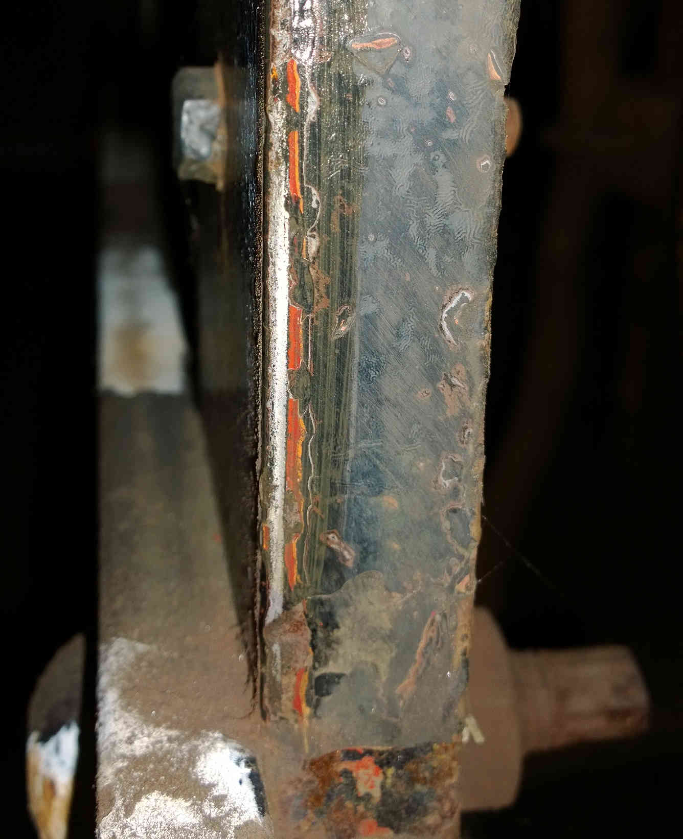

Unfortunately it looks like the Valley did a good job in completely removing the paint from the hood and cab exterior, but inside the work order bin, I did find some Slate Grey areas where the interior paint was rubbed away, but not positive interior grey was the same as the exterior grey. For the red, it looks like the Valley never stripped the railings or the pilot structure (or what ever the plates and bars that held the foot boards are called). Here is a nice cross section from the pilot bar, IIRC that was 1000 grit paper held to a board and cleaned with a wet thumb, just to see if anything was left. Shiny white IIRC was bare metal. It was just a quick test to see if anything was left back on a rainy day back in 2013, not sure if illumination was an incandescent Mag-light or LED, taken with a digital camera.

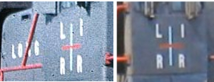

The lettering is overall smaller than all the other Ticheys, with thin shadow on the right side, not sure they did the light grey 3D effect like they did on the larger letters. Font might match the cars. I'm not sure of the color of the horizontal bar, I'm thinking it might be Day-Glo Orange, in other photos you can see it prints different than the railings and pilot, but still has a red tone. I would love to find a full broad side photo (or her paint diagram) of her to get proper proportions on the letters.

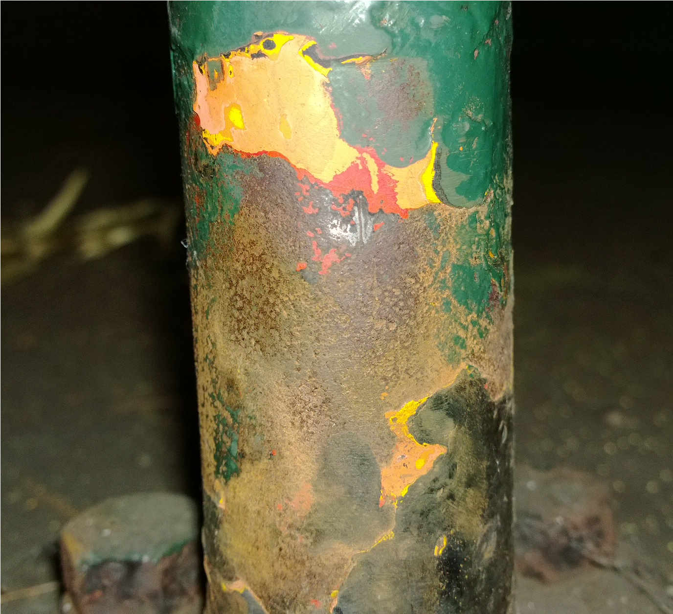

This one is the base of the railing. Red would be the 1950 Tichey, I'm guessing the creamy green (looks more pumpkin / light orange in the other photo) would be Dashing Dan in 1960, Yellow is Black River & Western in 1965, and the 2 layers of black is Valley RR (Essex Ct) in 1970 and not sure when they gave her the NYNH&H scheme.

Awesome. Thanks. That might be the best tichy red sample around. I have the paint diagrams for world fair rs1 and rs3 but they only reference paint numbers without a manufacturer reference. Wish I could find more to work with. At some point I plan to remove the radiator shutter assemblies and am hoping to find tichy gray at that point.
