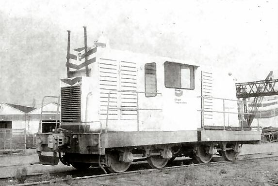

Would anyone here have any information on these Critters / Locomotives ?
http://www.northeast.railfan.net/images/bendix0.jpg
http://www.northeast.railfan.net/images/sksxZM12.jpg
http://www.northeast.railfan.net/images/cfp98.jpg
Thank You,
Mr. Starr

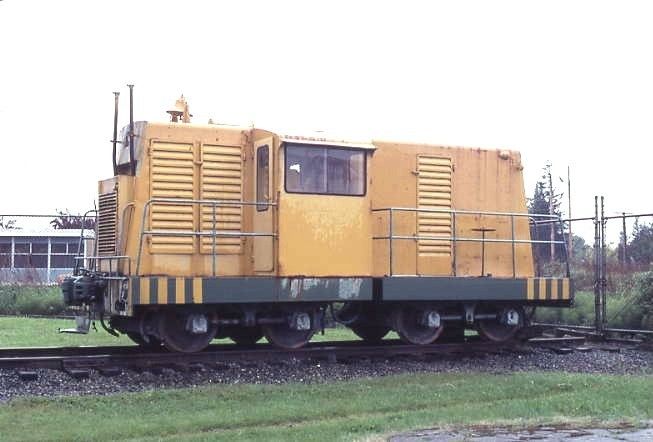

Skagit Steel & Iron Works Model ZM-10 C/N ZM-10A1 07-15-51 Waukesha* 30 tons B-B
West Tacoma News Print Co. Steilcoom, WA
Skagit Steel & Iron Works Sedro Woolley, WA plant switcher (here 11-53)
Skagit Division of Bendix-LTV “ 1969
Skagit Corp. Sedro Woolley, WA
Delta Corp. “
* Ford V-8 installed later still stored at abandoned plant site 2005
http://www.rrpicturearchives.net/archiv ... x?id=57821
Now owned by the Sedro Woolley Museum.

Now I'm not one to usual revive old threads, but the Skagit engine has me VERY curious. Was that built in house like the information seems to suggest? A friend I work with forwarded me pictures of the engine, and frankly I know next to nothing about that creature. Is there any sources of information regarding that locomotive floating around? My curiosity is piqued and I'd love to know more.
Dylan M. Lambert

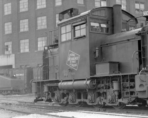

Never seen these locomotives before. Very interesting. Anyone know what the fate of this one was?

The Milwaukee Road Diesel above was build new by Baldwin in 1929:
https://rrmuseumpa.andornot.com/media/I ... ermark=wmk

As to the Skagit locomotive I did not suggest that it was built by them but stated it. It is the prototype of their ZM line.
ZM-10 ZM-10A1 07-15-51 Waukesha* 30 tons B-B
Delta Corp. “
* Ford V-8 installed later still stored at abandoned plant site 2018

The Milwaukee Road diesel referenced above was not built by Baldwin, but by Whitcomb. BLW did market Whitcomb locomotives, beginning in the 1930s or so, and eventually took over Whitcomb as a subsidiary, but long after the 1929 builder's date for that MILW unit.
