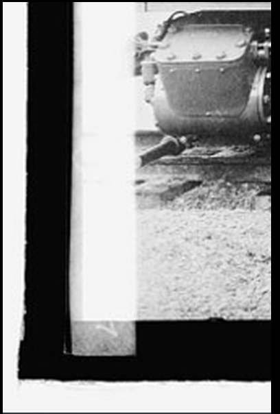

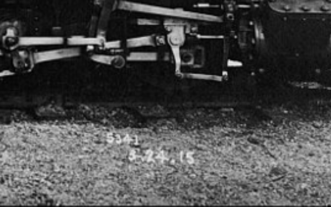

Baldwin ? ? It has the rotating over smoke stack cover flaps. That yells French. The photograph is dated 3 - 24 - 15 for March 24 1915 and the loco does not show 6 years of wear, from 1909 to 1915.
Check out the petcocks on the side of the water tank to check level !
I think this is a emulsion film positive print, that was taped onto black stock paper as was used in the old days for photo albums or photo mounts. You can see the tape holding it down to the black paper that has scissor cuts on the edge of the black paper. Also if it was a negative it would be reversed color and you would be able to see the edge of the glass slide. No glass edge, it is a paper print. That web site must have the picture miss-labeled. At least that is the impression I get, others may differ.
Sorry for the updates, I have not figured out how to delete a pic once it is added.
Dan

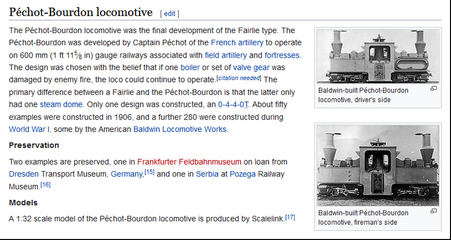

It is a Péchot - Bourdon locomotive.
https://commons.wikimedia.org/wiki/Category:P%C3%A9chot-Bourdon_locomotives
Mike
 Post subject: Re: Never Seen a Baldwin Steam Engine Like This!
PostPosted: Sat Dec 05, 2020 6:09 pm
484Mike wrote:
And it is a Baldwin built for the French military. BLW c/n 41944.

Wow, built by Baldwin for the French military, 1915 .
