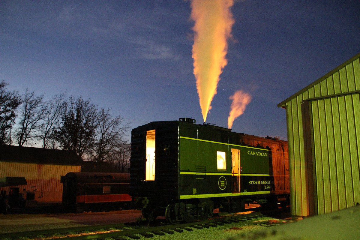

Well, Bubly beat me to it, but here is a photo of Monticello's ex-CN car in service, and a link to it in service on NS's Santa train in 2012.
https://www.youtube.com/watch?v=zkqgBDKnScI
As Bulby pointed out, we removed one steam generator and installed an HEP genset to provide electrical power to the train. (and the remaining steam generator) We currently heat four cars with steam, the rest being electric heat. Steam generators, at least the 4625 models, are easy to get parts for, as they are still actively supported, and in fact new ones are available, for about $75K per copy. Ours has been running pretty reliably of late. Mostly, we think, because we shake a box of spare parts at it each time we start it.
Kent
