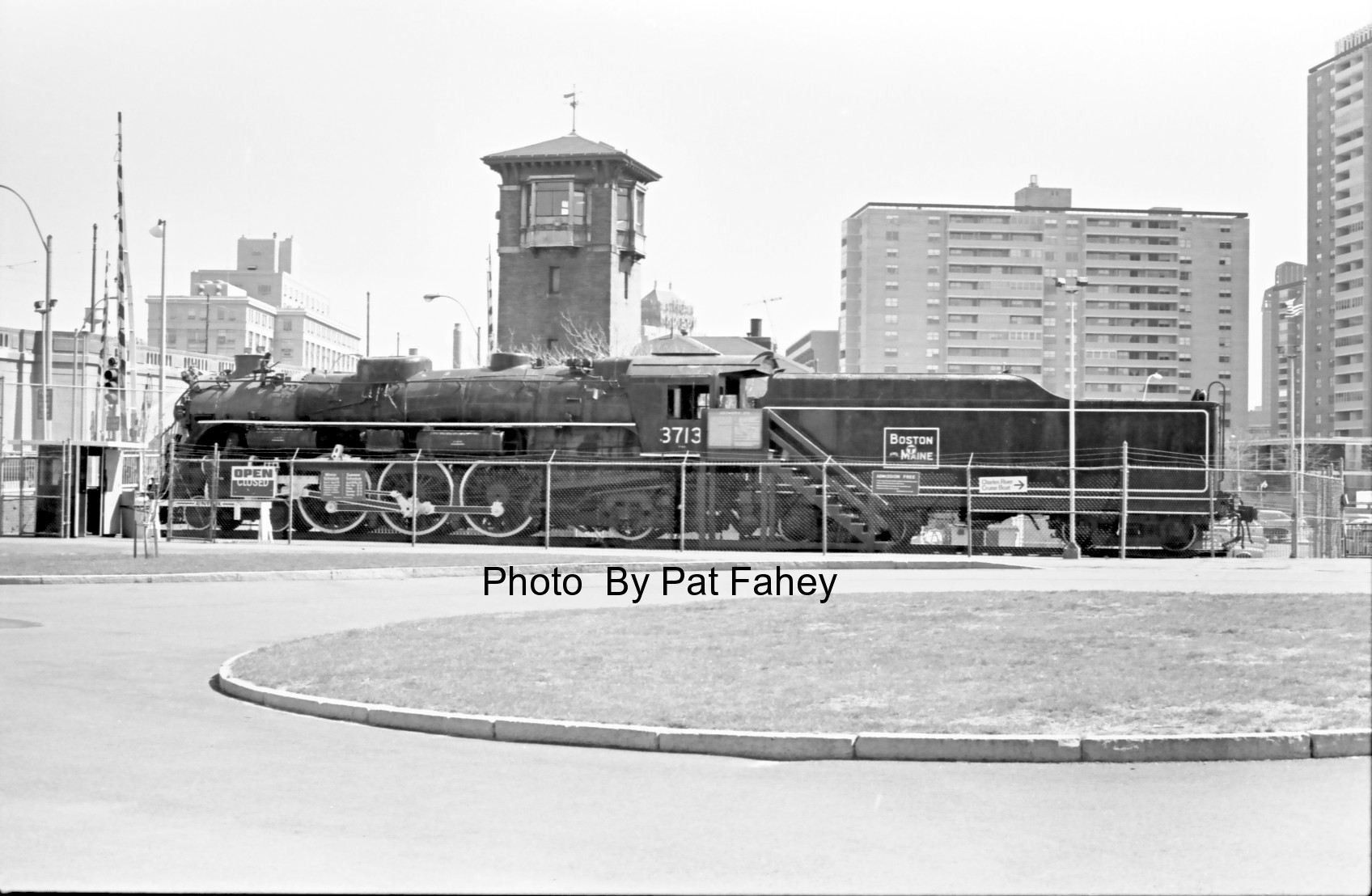

PostPosted: Thu May 27, 2021 12:28 pm
Posts: 605
Location: Milford,Mass
File comment: Photo by Pat Fahey Museum of Science Boston, Mass.
Hi All
I am happy to read on just how much progress is being made on the locomotive,
you are gaining ground and getting closer to the first firing up of the locomotive.
But each new bolt, or the cleaning of rust, bring the locomotive closer to the first fire, keep up the good work.
