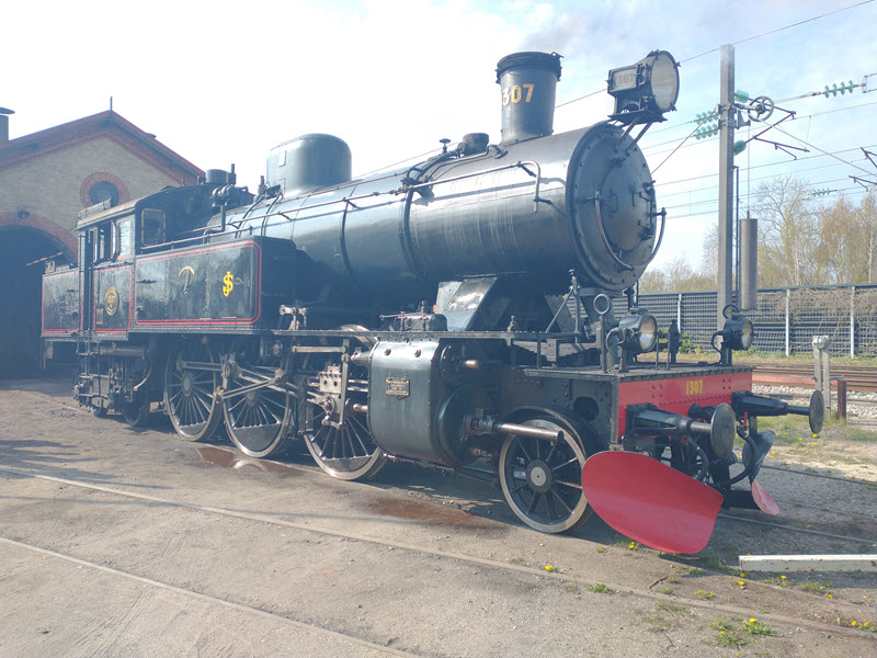

We have a possible buyer for our locomotive, SJ 1307, in the USA. Can anyone advise us on shipping methods from Denmark?
