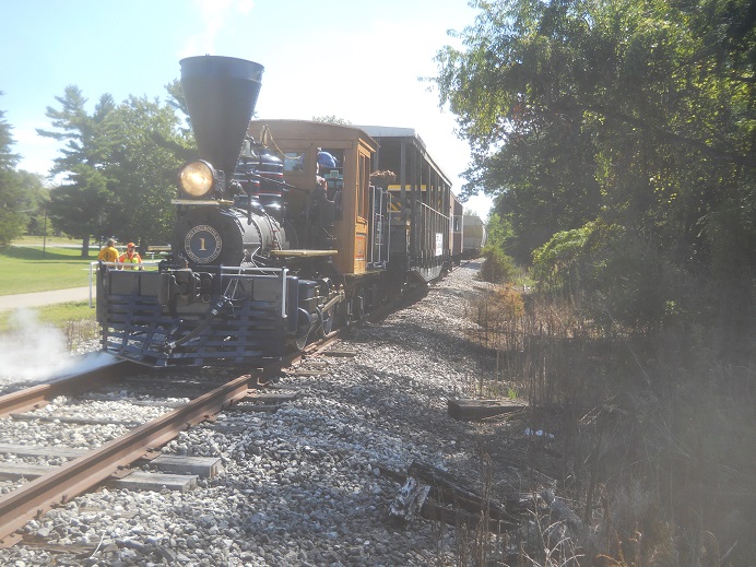

QJdriver wrote:
Everett,
I've got a Baldwin erecting card for Bock Lumber #1, a very cute 0-4-4T. It's in my emails, and I'd be glad to forward it to you if you can send me your email by PM.
Here's a photo of Bock Lumber #1 and her stack as mentioned by Sammy.

 Post subject: Re: Plans for diamond or rushton stacks
PostPosted: Tue Apr 25, 2023 12:30 am
Posts: 1676
Location: Byers, Colorado
Les & Everett,
The version of this engine with the diamond stack is fresh from the builder --- a bit different than in your foto.

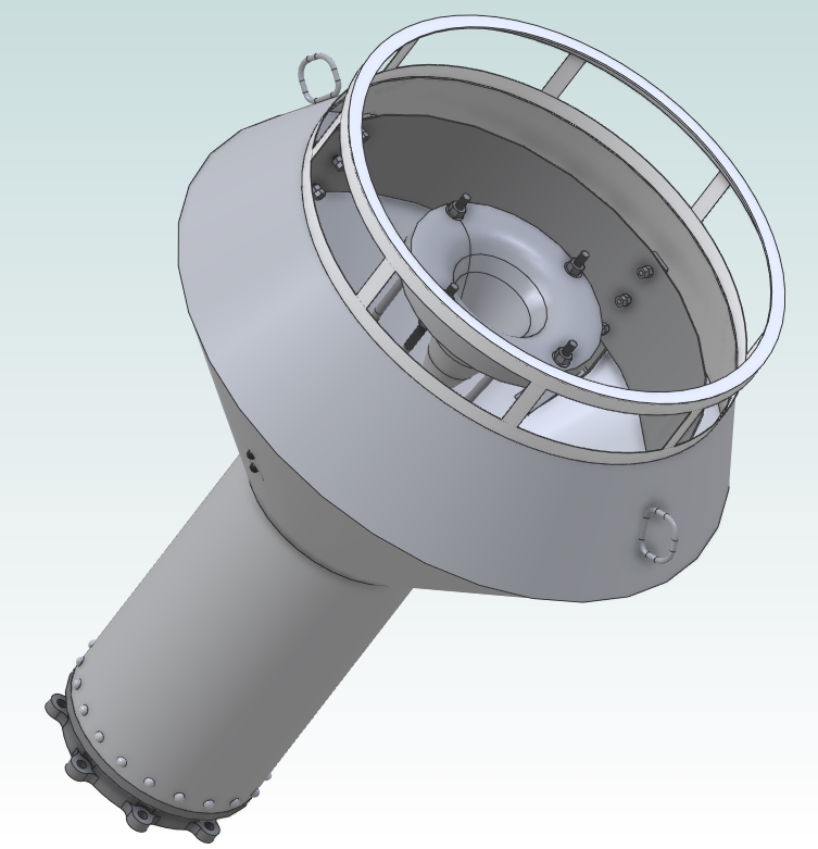

Here is a link to a dimensioned pdf drawing of the Lima Diamond Stack made but not used for Climax SN 1551 at Cass. The drawing is "As Built" following Standard Cass practice for its locomotives (except 1551 - aka No. 9).
This is CASS practice not Lima and may vary from from a standard Lima diamond stack although it uses a Lima Diamond Stack Cone.
Lima Diamond Stack (Cass 1551).pdf [227.98 KiB]
Downloaded 312 times
All dimensions are taken from the original. The only things missing are the Lift Rings on the Sides of the upper surface, the latches for the mesh stack cap and the mesh stack cap itself. Unfortunately, it was unfinished when MSR&LHA left its Cass Shop.
As an aside, on one occassion the 3/4" support rods on one of the Shays at Cass wore away to such an extent that that a number failed and the cast iron Cone fell down and plugged the inner cylinder which prevented the locomotive boiler from drafting much to the surprise of the crew of the locomotive.
