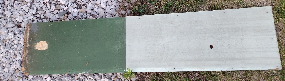

PostPosted: Mon Jul 10, 2023 7:12 pm
Posts: 211
Reviving my own thread.
This is what we found hidden behind some sheet metal the RR installed to protect the wall from from a heater.

Following up in case someone else searches for this info.
The good folks at Pullman Library were able to provide a bill of materials for the cars.
The list shows PPG codes 52847 and 52848 for plywood paint. From what I have been able to find those come back as a mint wintergreen and a gray.
The list shows a 52845 light ivory for primer. That looks to be the color I see in interior photos all over the web.

Hmm. Our car has light green behind the beige.

PostPosted: Sat Dec 23, 2023 10:41 pm
Posts: 2082
Bill - curious question: have you seen any samples of those PPG colors? I’m curious if the light green is similar to the run of the mill government “institutional green”. Might be able to find that in the Fed Specs. Since these are interior colors, a PPG dealer should be able to mix samples for you. They may have to consult the lab in Pittsburgh to get the formula close but it might be worth the effort. A actual sample is always best to have for matching. If you need to go to the lab direct, I may be able to help.
The paint that’s on there now is likely an oil base. You’ll have to seal it before you put anything other than oil over top so the new paint stays stuck on.
