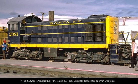

Does anyone have any leads where the Pacific Southwest Railway Museum can find rubber gaskits for the ALCO S-2 ATSF 2381? We have found one company which might be able to produce them at an extremely high costs. Changing out windows was one way commercial railroads dealt with the problem - not an option for the museum.
File comment: AT&SF #2381 ALCo S-2
