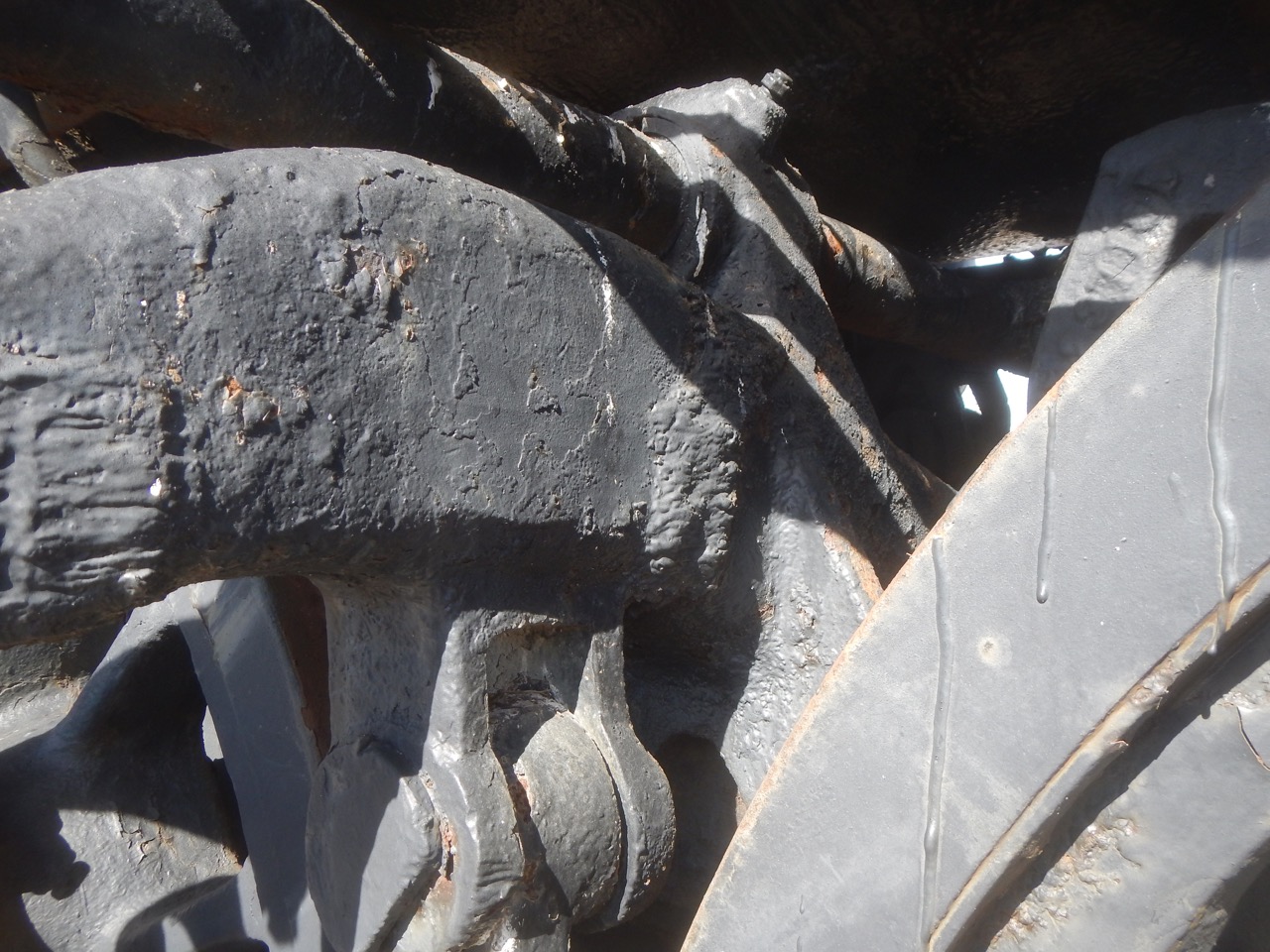

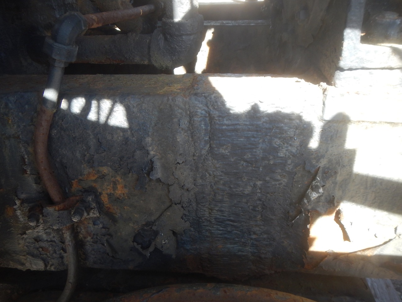

Here are a couple of photos of welded repairs to PRR M-1b No. 6755 at the Railroad Museum of Pennsylvania, taken this afternoon. One shows a massive weld to the frame just behind the cylinder block, while the other shows repair to the link block. Looks to me like the engine was side-swiped or hit something pretty hard. The cylinder half-saddle is a replacement as well.

Mr. Laepple, is that a cast bed or just cast-steel frames? (They would weld about the same but be fabricated differently).
ISTR a couple of instances where cast beds were severely damaged, and I think this led to the engines involved being scrapped. I don't think the Hudson in the Gulf Curve accident at Little Falls had a full cast bed but was certainly not repairable; the situation could be that damage substantial enough to knock a bed sufficiently out of line would 'total' enough of the other structure and other components on the engine.
