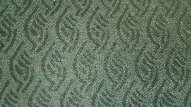

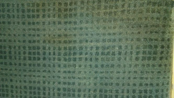

Without starting a debate, interested to know mainly 1) if and where velvet fabric matching the patterns in the pictures below might be currently purchased?
These fabrics are from an armrest and seat upholstery on a Pullman Sleeper. The pictures are not at the same magnification, see the figure comments for the pattern sizes. It is unclear to me if the fabric is from the 1940's or later. Sleeper last used on Santa Fe. Background color possibly could be considered a blue (with slight green tint) with nearly black contrasting pattern.
Related questions might be 2) what is the pattern name and/or identification and 3) any good or bad experience (for preferably successful) cleaning of this type of older fabric?
File comment: Size of largest dark square in pattern is ~5/32" (just greater than 1/8")
File comment: Size of dark pattern is ~1.75" x ~7/8"

I would add that upholstery fabric in the pictures I uploaded is not original to the car. I would be just guessing to say anything beyond that fabric in the pictures is different than the original. Possibly this is a fabric Pullman used at a later time period, or ATSF replaced it, or someone else?
The original upholstery was possibly Pullman Pattern 1315-84 but I doubt there is much if any of that remaining on the seats. For the moment just trying to consider if replacement of fabric on a few items is possible (replacing everything I expect would be very expensive).
