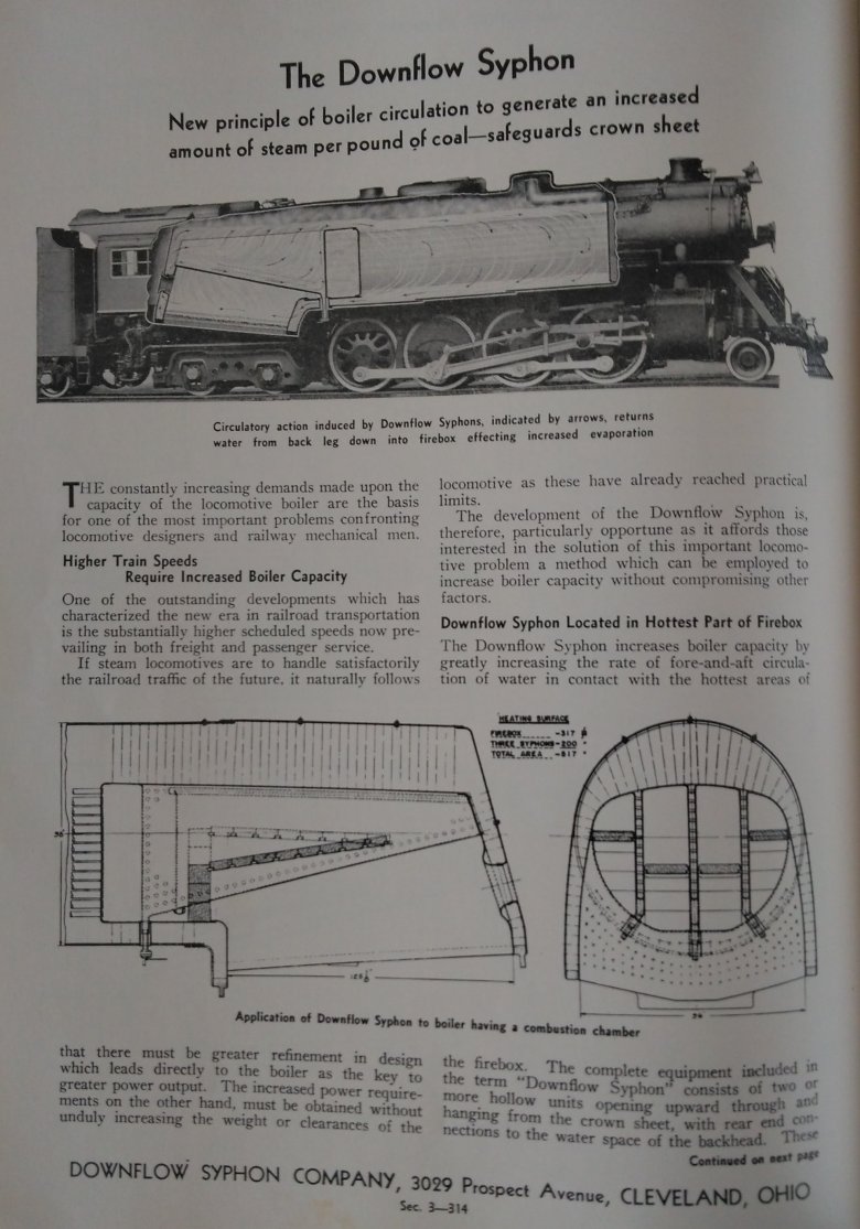

Just because it was in the Locomotive Cyclopedia, doesn't mean it was state of the art.
How many people know of the Downflow Syphon? It was listed in the '38 and '41 Cycs.
The induced circulation patterns presented belong in a fairy tale.
Patent US2080269 by Charles Gilbert Hawley.
Extra Credit: Why would it not last a month in heavy service at high firing rates?

They used a Wheeling & Lake Erie Berkshire for their illustration.
https://www.railarchive.net/randomsteam/wle6401.htm
