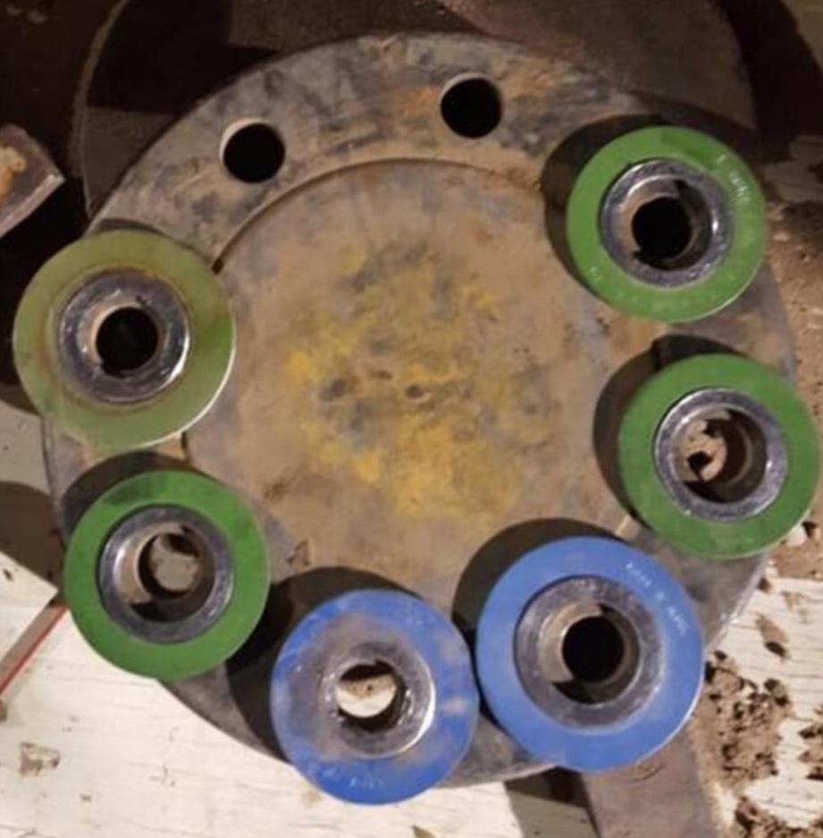

Captioned "New guy keeps asking for more gaskets"
-Sam
