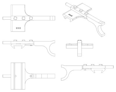

Climax Class A Gear Shift Arm. Simple and effective.

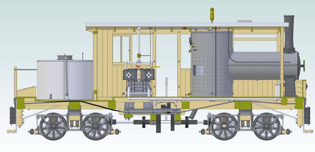

Section View just inside Right Side Sill
 Post subject: Re: CLIMAX A-313
PostPosted: Fri Oct 18, 2024 8:36 am
Posts: 1116
Location: Warren, PA
Well, that cross section answers one of the questions I've never been able to understand about Climax A's. Looked at a lot of photos, and it was pretty easy to understand the steam piping from the top of the "dome" or vertical boiler, across under the roof, and down to the cylinders. Clearly visible. Other than 'don't grab that, it's not a handrail!'.
But where did the exhaust steam go? I could never figure that out.
It went under the floor back to the smokebox? No wonder it doesn't show on photos!
I've even looked at the locomotive kit at Corry spread on the floor and couldn't figure that out.
The detail that impressed me looking at the actual parts was the transmission and gearshift, another place not to stick a hand or foot into under motion.

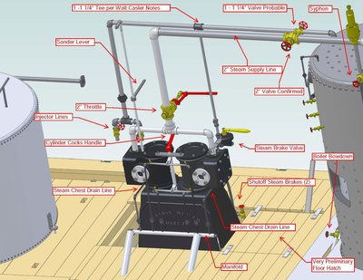

Very preliminary illustration of steam lines and ancillary piping on A-313 with labels. Subject to change without notice.

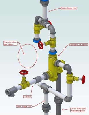

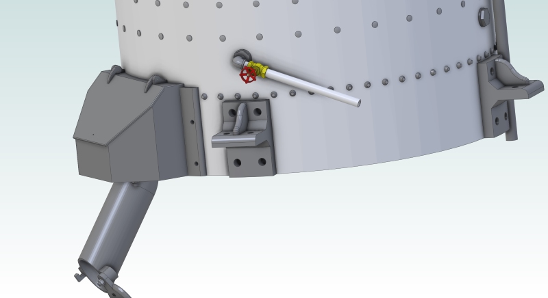

Preliminary drawing of plumbing of the 3/4" Penberthy Injector on A-313. The plumbing between the "blue" fittings has been found in one piece. The drawing is based upon a photograph and should be considered an illustration. The only "period" fittings are the "tees", the balance are modern temporary substitutes (particularly the valves).
The Penberthy Injector is a solid model prepared from scaled photograhs and modern literature. The other type of Injector TBD after looking at the number of injectors CORRY RAILS retrieved from Alaska and comparing with a photo in which it is partly obscured.
