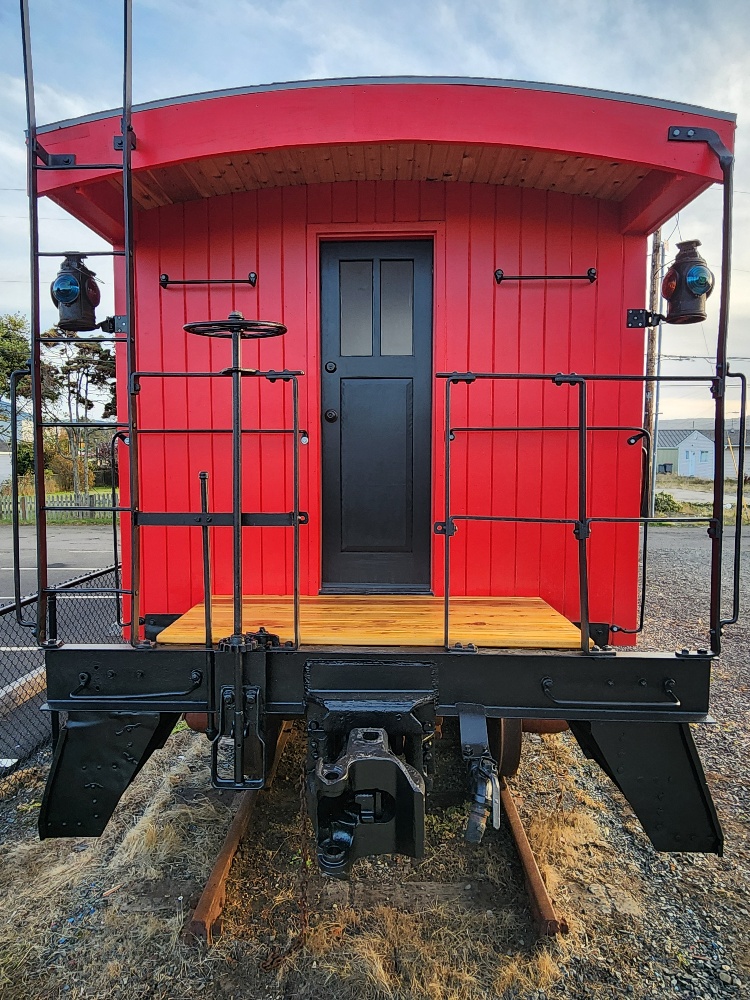

Was there a standard for caboose marker lamp light signals?

Finished the rear platform out of cedar and stained it today.
It depends on the railroad. Some were red/green, some were red/yellow. If you can find an SP&S rule book for your era, it'll be in there.
Typically, when running, red shown to the rear. If standing on a siding or passing track, then yellow or green to the rear so as not soil the trousers of the overtaking engineer.

Time to start on the other platform and railing. At least I’ve got one good side to look at!
