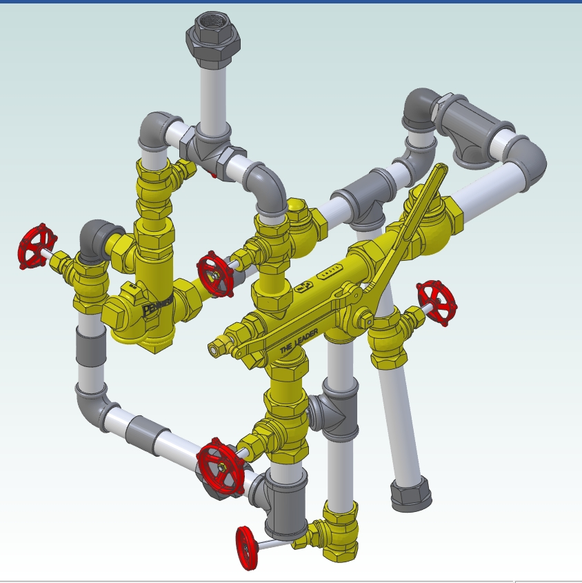

The work to recreate/reassemble the piping connecting the Injectors/Boiler/Cistern is a Work in Progress. The few photos available are old, blurry, out of focus, leave areas hidden by parts between the camera and what one wants to see and taken from positions which are less than ideal.
One photo APPEARS to show a drain line from THE LEADER injector, however its possible/probable connection to that injector is obscured as is the pipe line below the valve. The location appears to be right but I do not assume anything.
Any Steam Heads out there who can tell me why a drain line from an injector would have a Tee & Plug (the Plug may have been installed to keep waste out of the line after removing some part?) and the Valve would be installed.
The Valve appears to be a backup to the internal valve in THE LEADER.
A screenshot of my most recent iteration of the injector piping and the specific line are below.

PostPosted: Thu Jun 05, 2025 7:31 pm
Joined: Wed Dec 02, 2015 10:38 am
Posts: 172
Location: Vienna, VA
A couple of views of the revised Injector setup on Climax A-313. Modified to reflect the actual piping found. The biggest changes are to Tail Pieces which connect to the Injectors and the two (2) Check Valves which I had not identified due the quality of the photos and lack thereof. No other real changes.
Valves are modern but will be changed to period pieces when I have time. The LEADER is correct as to size, etc., but the Handle is done from a dimensioned photo.
