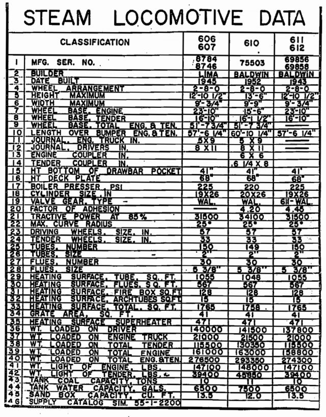

Here is shot of the S-160 spec sheet from the MRS folio as well.
